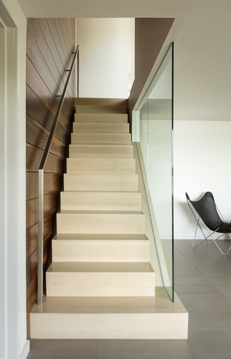

Here's an example of something comparable that I designed and detailed. It could have been done easily with visible fasteners but we wanted a high level of precision and no visible fasteners, wood filler or plugs. The solution involves Richlite splines milled with a custom pattern.

Did you do a T&G type joint to hide the fasteners? Looks nice!

Looks wonderful. The Richlite joins the wood slats (I assume), what element connects back to the base wall?
Dec 19, 19 2:12 pm ·
Thank you. The walnut boards have grooves in the edges plus a rabbet on the back on one side. The Richlite is milled with a "T" shape. We worked out the dimensions such that the Richlite splines are screwed to the wall, then the walnut slips over the splines and hides the fasteners. It was difficult because neither the wall or the walnut were perfectly flat, so every pre-finished board had to be massaged into place. (The boards have a true hand-rubbed oil finish.)

Very cool. I'm not sure where this project is located, but did you have any problems with the walnut expanding/contracting over the seasons? Did you leave a reveal at either end? I'm assuming richlite is static.

threeohdoor, it's on the Maine coast, which has wider humidity swings than most places--wood moisture content is around 6% in winter and 14% in summer, unless A/C is used. I use formulas in this book to determine how much movement to plan for: https://www.amazon.com/Understanding-Wood-Craftsmans-Guide-Technology/dp/1561583588/, which varies with species, grain and season.
I have not heard of any issues with this wall, and it's been up for 5-6 years now. The entire perimeter has a half-spline so there is a clean, consistent margin.
Richlite is made of layers of kraft paper and phenolic resin, just like plastic laminate countertops, but without the clear melamine layer on top. It does not move enough with either temperature or humidity to worry about.
